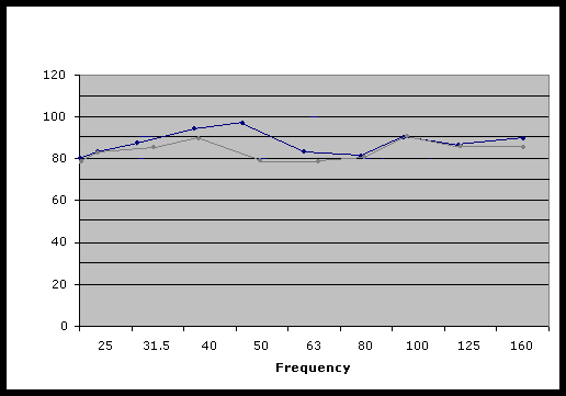

    L.J.
    2 Attachment(s)
    Originally Posted by GMichael
    Gremlins! That's it, I must have gremlins. Someone keeps turning up my sub. I've turned it down 3 times already only to have it get too loud again an hour or so later. Is this a break in thing?
    Half way through last night the sub seemed to be over powering my system again. But this time, instead of turning it down, I started playing with the parametric EQ. Haven't stopped by Rat Shack to pick up a meter yet, but never let it be said that anything will stop me. Equipment, knowledge, who needs it? Here's what I did. With the gain turned up to +4db I started turning the dial up from 18htz. When I got to about 60htz the boominess more than doubled. So I left the dial at 60htz and turned the gain/defeat down to -3db. Now it sounds great again. Doesn't overpower the system, but still hits like a ton of bricks when it is supposed to. Maybe some day I'll get off my lazy ars and ride the 5 miles down the road to the Shack. But till then, I'm a very happy man.:ciappa:
    Hey GM, have you had a chance to calibrate your sub yet?
    I finally pulled out my SPL meter and Rives test tones CD and was able to really get my sub dialed in. Take a look at these before results:
    http://forums.audioreview.com/attach...1&d=1175268181
    The blue line is my first measurement. The gray is I guess my halfway point. I did alot more measurements, but only put a few on graph.
    As you can see I had a HUGE peak at around 40/50hz. I was unable to properly set my sub level because of it. As a result, I had to set my sub's level really low. I knew it was there but the room measurements confirmed it. I was able to cut the peak down using the sub's eq. Cutting that one peak down made a night and day diff for my bass. The improvement was crazy. The sub blended with the rest of my system so much better. I was able to go in and properly set my level now because the peak was not screwing everything up. The bass is deep,but so freakin' smooth.
    Here are my results now:
    http://forums.audioreview.com/attach...1&d=1175268750
    As you can see, the response is a heck of alot smoother now. I still have a peak at 90hz and a few bumps that I plan on taking care of it in the future(can you say BFD), but for now I have some pretty decent bass. Anyways, I thought I'd share my results with you and pressure you to spend some $$$.
  • 03-30-2007, 08:27 AM
    GMichael
    Oh! Very promising results. Congrats on a job well done. Doesn't that peak at 90 have more to do with your mains? What do you have the crossovers set at?
    No, haven't done mine yet. Still sounds great though. Just doing it by ear I was able to get rid of what seemed to be a peek at 60. I have put a spending freeze on all purchases until further notice. Don't want to buy more new stuff just before I have to move it, again. May very well have to leave some new stuff behind as it is.

  • 03-30-2007, 09:07 AM
    kexodusc
    Originally Posted by L.J.
    Move it???? :confused5:
    Yep, it's the mains. My xover is set to 80hz. I'm gonna see what happens when I change it to 60hz.
    LJ. I'm curious to learn what happens.
    What size is your room (w x h x d)? Any 19 ft-ish dimensions by chance? I have a feeling this could be a room mode issue, but you might also try moving the speakers further out from the wall or tinkering with sub placement.
    Setting the XO lower could make it worse. If your receiver has a 24 dB/octave filter, you're moving the cut in the 90 Hz region further away.

  • 04-02-2007, 05:28 AM
    L.J.
    Well I did a few measurements and using a 60hz xover causes a huge dip(-9) right at the xover point. The peak at 100 was still there. I tried playing tones at different volumes and had the same results each time.
  • 04-02-2007, 06:04 AM
    kexodusc
    Yeah, it's definitely looking more like a room induced peak at 100 Hz...don't feel bad, I have one around there too.
    I did some calculations based on your room measurements, assuming your room to be rectangularish....you have room modes at 94 and 117 Hz (resulting from the 24 ft dimension), 80, and 121 Hz (from 14 ft) and some nasties in the 100 to 125 Hz range from that 9-11 ft slanted roof.
    That's not uncommon (and not unlike mine, my room is 24 ft long too!) , but it's a lot of activity in that 90-120 Hz range which is causing you the grief. They should be especially prominent at the 110-120 Hz area...have you tested that high? And again 250Hz and 300-400Hz where lots of multiples are close together, though your room treatment might be softening the last few somewhat, and there's not really much you can do there (and you may not notice it as much?).
    This is just the theory based numbers, the presence of your room treatement, furniture, and room architecture is likely to shift those all a bit, so precise peaks are hard to predict, but we're definitely in the ballpark.
    You might find changing the sub placement or speaker proximity has some effect, though I expect it will be small. Ideally, you'd have some room treatment to soften the blow somewhat in that 100 Hz -125 Hz range. Even then I'm not sure how much better corner traps would make it. That frequency area is kind of nice though, lower bass is absorbed less by bass traps, and higher frequencies become more directional so their level at the listening position is not altered as much.
    I really needed to put a cut on my 90 Hz peak with the BFD, it has a wider Q, so it just filters the sub lower. I flip back and forth between an 80 Hz, and 100 Hz XO for my sub.
    Despite popular belief, the higher XO isn't terrible, and my sub at least doesn't really start becoming directional until 100-110 Hz or so. If I ever get around to building the 2nd one, that should help somewhat. I have corner traps that help a bit, but I live with some mess at 115 and especially 140 Hz right now.
    Oh well.

  • 04-02-2007, 07:19 AM
    L.J.
    I tested up to 160hz. There's peaks at 125 & 160 but not as bad as the one at 100hz. I toyed with sub/speaker position but I'm pretty satisfied with my results. Besides, that freakin' Titanic is heavy :(
    I'd like to do some measurements after running my avr's room eq setup, but I can't get it to take any correct measurements. It keeps setting all my levels(except the sub) to +12db. I know they don't eq well in the lower freq, but what's considered low?
    One problem I still have is echo. Not sure if that affects the lower freq or not. The room is a living/dining room. I only treated the HT side of the room. The dining side has the highest ceiling point and alot of bare wall still.
