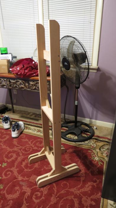

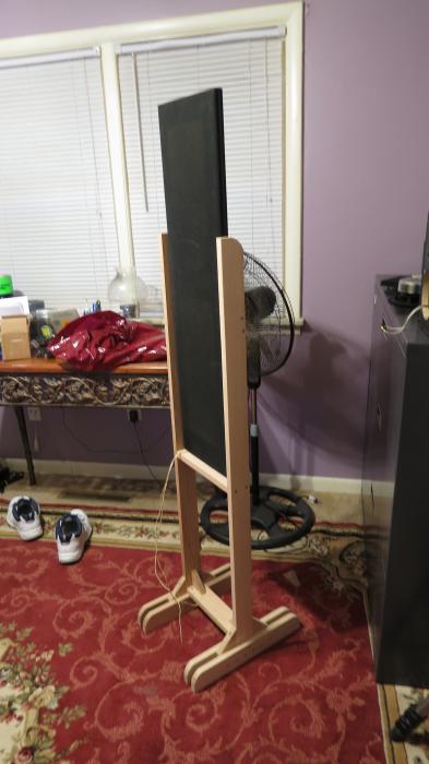

    I needed some stands for my friends MMGW's and those don't exist, so... I'm in the process of making my own. Here are a couple of pictures of what I have so far...
    BTW, You can also use these stands for the MC1's and these can easily be modified for MMG's... (just use longer cross braces between posts) The stands bring the speakers 2 feet off the floor as per Magnepans recommendation.
    I wanted them to be strong and yet keep that open look. It costs about $70 to make (both) and I used a chop saw and a hand sander for smoothing the curves.
    Hopefully these will be finished before xmas as they are a gift.

    Oh wow those are too cool Steven. Are you going to stain or paint them too?

    I'm thinking of staining them, but am a little undecided of which direction to go. BTW, they are made from oak. Any ideas?

    Nice job!
    I few years ago I made much less magnificent stands for my own MMGs. They were decently effective though. They simply bolted on instead of the standard 'L' bracket stands.

    For the MMG's your stands make more sense. I like them! It looks like they're plenty strong, perfect! I like them in black, looks good. The only real difference is that I put two boards on the side of each leg.
    It's hard to explain, but I made my stands heavier duty because my friend is hard on stands. I knew that if I bolted the panels to the frame that she would soon have them ripped off. The other thing is that the MMGW's are not as tall as the MMG's so they had to be raised up too much to make a stand like yours strong enough for this purpose.

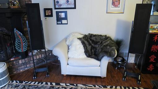

    Here's one mans version of a maggie stand.... This makes our stands look like toys.
    Stands for mmgw-1521732_563054320440257_1894512856_n.jpgStands for mmgw-1525527_563055483773474_1261271198_n.jpg
    That guy's stands are very impressive -- and massive. Looks like he did some crossover mods too.
