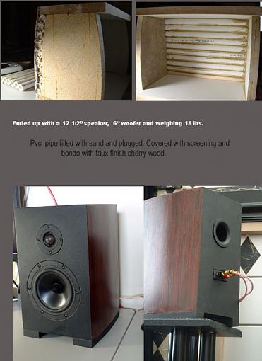

    I used the rs150s in this speaker with a TB tweeter. After all the work I put into this Bondo baby I was a bit hesitant about using a <$30 driver but so far I'm pleased.
    Attached Thumbnails Attached Thumbnails RS28-RS150 Done-fourpix-copysmall.jpg

    That's very unique
    and I like the curves. I sure you spent a lot of time putting those together. Very nice looking, congrats. Paul.
