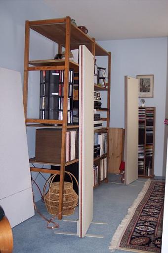

    What I do for my Maggie MG 1.6QR is shown in the picture below. The ceiling pannels about the height of the Maggies; they absorb a little of the backwave and deflect the rest. It works well: the sound is clear and the imaging precise.
    Another suggestion of mine is to get a few sheets of this egg-shell foam damping; maybe stick it on a sheet of perf board rather directly on the wall, and if you like, cover it with some speaker grill cloth for a more esthetic look.

    NF, below is a pic that shows most of a ceil panel deflector. (Not a particularly elegant but unobstrusive.) They are just plain, beige ceiling tiles of a relatively high absorbancy type; each is stiffened behind by a couple of 1x4s.
    The egg carton foam ain't elegant either, but covering the panels with some speaker grill cloth like this stuff would help a lot.

    Nightflier, how handy are you? I've used the ceiling tile method before, good for higher frequency absorption, decent at reflection points, for stopping slap echo, etc, but it loses its effect much below 500 Hz, which I found created a tonal imbalance in my room. It traded one problem for another.
    Rigid fiberglass or mineral wool of 2" thickness or more is much more effective material. You'd need to build a frame or buy some sort of fabric to finish it though. Search for LJ's thread on the matter, or I think my member gallery has a few picks. Each 2 x 4 panel didn't cost me more than $12 or so, and you can make it to whatever shape you want.
