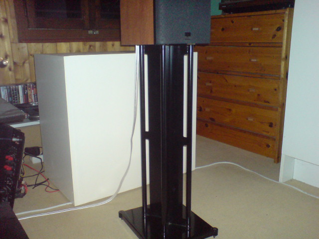

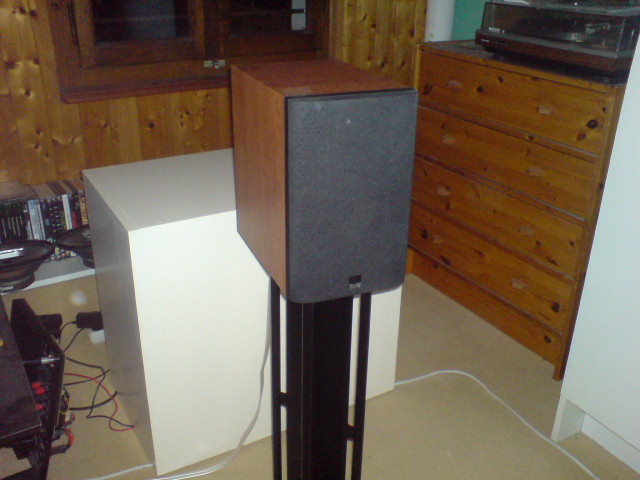

    So as I was telling GM the other day, I've completed a subwoofer project which is actually the finishing of a semi finshed/working build I made 4 years back. At the time, it was my second subwoofer build and first ported build. I had left the exterior unfinished, and the sound was terrible (distorted even at low volume). It was a 3.5CF ported box using a cheap 12" Sony driver.
    I thought the problem was with the driver/enclosure mismatch but in fact the bracing partitions in the enclosure weren't letting enough air get from one chamber to the other. Eventually I gave the driver to a friend and left the box sit in the basement for 4 years.
    Recently i was contemplating using a decent driver in a new enclosure (sonotube) but then I figured I should give my dying enclosure another try. I went for another 12" driver (apparently a variation of the Lab12 Eminence driver) built to spec for a British company who also makes OEM products for other audio companies, such as REL. It models perfectly with this enclosure.
    Anyways, so I worked on the partitions (tough job given the limited room, did most of the cutting with the hand saw), placed the port a little differently which required adding another sheet of MDF on the side where the amp and port were - I decided not to mount the plate amp on the enclosure like I had before. Fortunately the previous 12" hole was just the right size.
    The colour paint I had planned to use was white, but I went with mat white as there was some in the basement already. I did buy some primer. 2 layers primer, 2 layers paint. My sander is crap so there are still some uneveness but it looked good enough so I just started painting it anyway. I am quite please with the outcome. Here are some pics, it sits behind the right speaker in my bedroom

    Visually speaking, there's no denying the new driver is a completely different beast.
    There's a couple more to come...

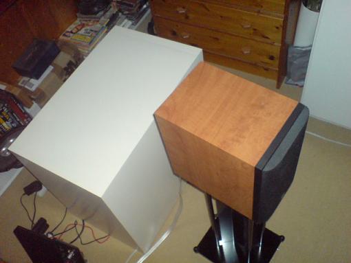

    France
    2,523

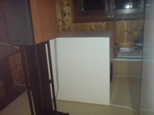

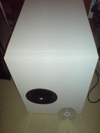

    The 4" port...
    Bottom pic. The small improvised feet using doorstops (I think that's what they are for...) + binding posts. The feet give enough clearance for the connections

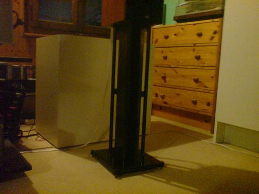

    Only pic without flash just to give you an idea
