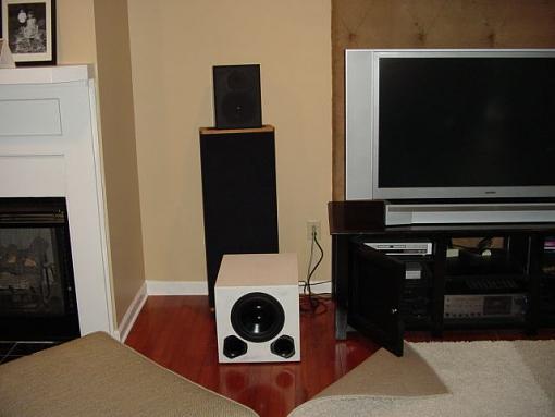

    I just built this kit about a month ago:
    Titanic MKIII
    And it will shake the dishes in the cabinets heck the whole house!

    That is exactly what I did. I had one up and running all weekend, they sound marvelous. I have them matched with a Peerless HDS midbass driver. Both drivers deliver very, very clean sound. I am very impressed with the Reference / Hi Fi driver. It is the choice for music. Shell out the $250.00 and get yourself a couple of them. You won't be disappointed.
    Attached Thumbnails Attached Thumbnails Dayton 15" Quatro vs. Titanic MKIII-subs_1.jpg   Dayton 15" Quatro vs. Titanic MKIII-subs_2.jpg   Dayton 15" Quatro vs. Titanic MKIII-proto_1.jpg   Dayton 15" Quatro vs. Titanic MKIII-proto_2.jpg
