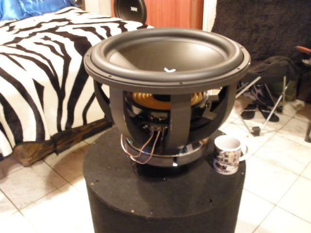

    And finally the monster RE XXX subwoofer driver
    Attachment 6868
