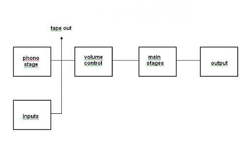

    There are no risks involved to your Arcam. The volume control of a receiver/preamp/integrated amp usually comes after the phono preamp. The signal going to the tape outputs is taken before the volume control. See the diagram.
    Attached Thumbnails Attached Thumbnails Using a receiver as a phono preamp-phono.jpg

    A Tape out passes the signal just after the phono (pre-pre) amp stage and selection stage. All this is done BEFORE the traditional preamp functions such as volume, balance, tone controls, etc... All of which add additional amplification to the signal.
    IOW, by using a "line out" between the preamp and the power amp you will be passing the output of your receiver's preamp stage into the input of your new preamp. This would require you to adjust the volume control on both the receiver, the tone controls WILL have an effect on what's passed to your amp, etc.
    While it probably would not damage it, it may not sound as "pure" as you would like. The worst you vould do is overdrive the input stage of your new preamp.
    The tape out stage passes the signal to your amp BEFORE all these additional stages. When using a receiver's phono stage, it's always done (at least properly done) via the tape monitors. But, it's your choice.
    Addendum: Using Glen's diagram, most "line level" outputs labelled as such are tapped between the "main" and "output" stages. Also, it clearly shows where the tape monitor outout is tapped.
