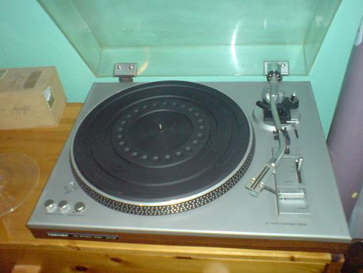

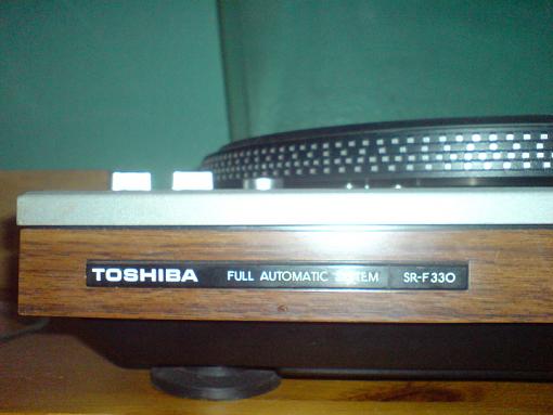

    I managed to get a TT off a friend last year and I'm hoping to give it life in the near future. I believe it came part of a complete seperates system (Toshiba) in the late 80's. I also have the pre-amp and amp but gave those to another buddy. Anyway, the TT is a Toshiba SR-F330, and here are a couple pictures.
    Does this look pretty bad or is it going to give me half decent sound? I don't have a phono stage so i'll need recommendations for a cheap one.
    I have never setup a TT so i haven't a clue how to do so. Can you stear me towards some good instructions for that? I know Im not the first one to ask and Im not expecting you guys to write it out for me. Also, Im not 100% familiar with the terms used concerning the different parts of a TT, so another guide on that would be good.

    That table looks great! Similar to my Pioneer. Love the silver with wood trim. Looks like noob beat me here, he's given you a good starting point. I would second the cartridge topic. Try to assess it, if you can get away with a stylus (needle) swap, you're gold. How much money do you have to spend?

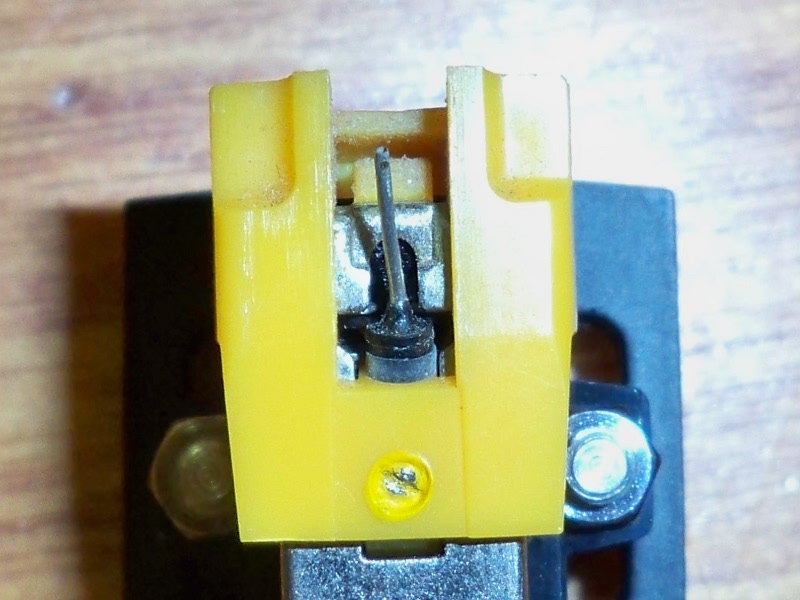

    Just check to see whether the cantilever is pointng straight.
    This will be easier to see if you cartridge body is a simple square type.
    The easiest way to inspect is to take your cartridge off of the headshell, then look at it from the bottom.
    Kinda like this view...ouch.
    It might be best to go ahead and replace the cartridge to be on the safe side, but it still may be good. The only way to determine that is to take it to your local hifi shop, and have them examine it under a microscope.

    Lol, that 'underside' view doesn't look right
    I think i may be at a loss concenring what the cantilever actually is. Could you expand? Also, I'm not sure what you mean by straight. With respect to what exactly?
