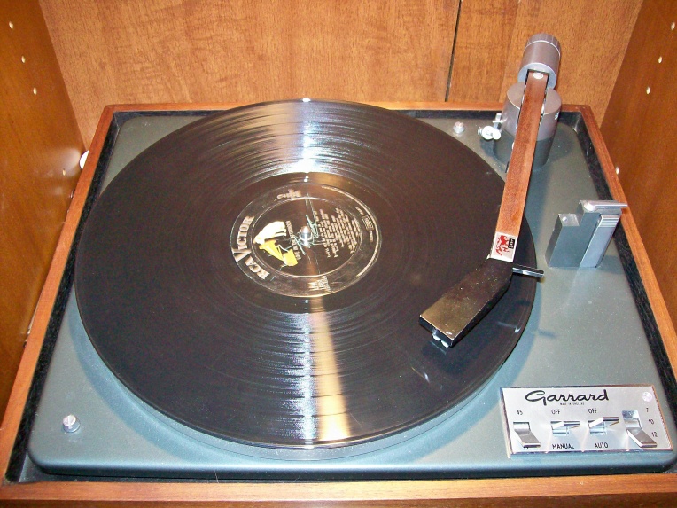

    Forum Regular gillsev's Avatar
    Nov 2002
    140
    Garrard Lab 80 - World's Finest Automatic Turntable
    Quote Originally Posted by emaidel
    ... the dreadful LAB-80 Garrard model (Garrard's first to use that type of wooden tonearm), that was the most notoriously troublesome unit Garrard ever made.
    Sorry Emaidel but I respectfully disagree with your statement. The Garrard Lab 80 was the best engineered Automatic Transcription turntable in 1964. It was the best of its time (second only to the 301 & 401 respectively). I was able to dismantle one before. The craftsmanship and engineering design of the auto cycle was superb. I still have mine from 1964! That is 45 yrs. old (my age too!) but still functions like the first day I got it!
    Here is a review of it from the United States Testing Company (April 1965) ...
    http://img111.imageshack.us/img111/8...repportay9.jpg
    64
    The United States Testing Company? Wow. Back in the day when people cared about cool stuff working well and not just vacuum cleaners and air purifiers.
    To the original poster, you need to find out what kind of compliance you should be using for your arm, and then take it from there.
    Edit:
    Read the USTC review. They say the arm on the 80 is appropriate for any cartridge, from the highest to the lowest compliances. That is absolutely mechanically impossible.
    The tonearm mass, mass distribution, and cantilever compliance is a constant in turntables and there is no arm in the universe that will work with all cartridges properly, i.e. getting the resonant frequency high enough so that the arm follows the record and low enough so that low-end music information in the groove does not cause movement in the cart & tonearm.
    Makes me wonder if USTC was just a marketing name for a magazine meant to sound uber-professional. That said, I know nothing about the automatic turntables you guys are talking about, but I do know that statement is a stretch.
    Nov 2002
    140
    Quote Originally Posted by Reticuli
    I agree with you, Reticuli. I don't have the specs of the Lab 80's tonearm per se, but judging accordingly, I believe it's effective mass could be between 15 to 25 grams which will be considered a moderate level. Therefore I can use moderate to low compliance cartridges (i.e. between 5 to 20 um/mN). With that in mind, I am using the Shure M91ED cartridge for it, tracking at 1.5 grams.
