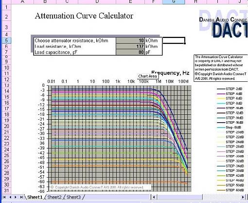

    This is the first of three factors that determines compatibility. Low output impedance of the source is also desirable to provide a suitable input to output multiple. See attached link for calculator to determine potential HF rolloff.
    DACT calculator
    Balanced or not, the second factor is cable capacitance. The lower the better.
    The final factor is gain. Some folks say they lose dynamic "punch" with passives. I think they simply don't have enough gain. My CDP has a 4 volt output driving 1.3 volt sensitivity amps. I can clip them at will.
    Perhaps I'll try some of the math sometime. I do know that the Monarchys' input impedance is supposed to be a good match for passive preamps but I can't quote the spec offhand.

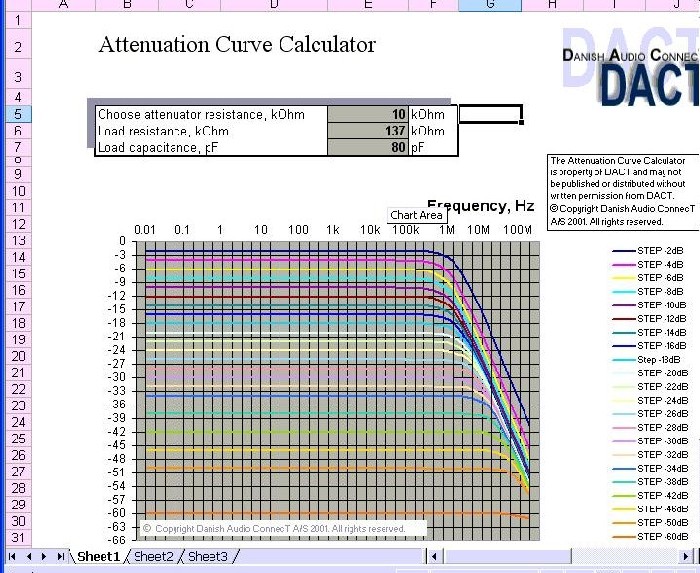

    All the calculator needs to display response curves is:
    1. Amp input impedance (kohm)
    2. Cable capacitance (pf)
    3. Attenuator resistance (kohm)
    edit: Unless I'm playing a particularly low level recording like a Telarc, I usually get full output at around -12 db.
    So ...
    • Monarchy SM-70 Pro amp input impedance is 100kOhms;
    • Blue Jeans balanced cables are 13pF/foot, hence 78pF for 6 foot
    • Attenuator resistance is -- what? my Adcom GFP-750's output impedance, presumably at 0 dB attenuation, is 1.2kOhms, which is much lower than the calculatior allows.
    It would seem there is essentially zero attenuation any where in the audible range. Right??
  4. #54
    I would say so. What is the output impedance / gain of your source(s)?
