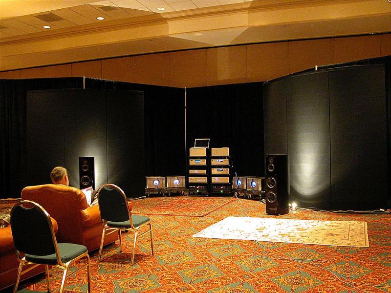

    It will require a really special speaker to woo me away from the U-1s. Have you ever heard a Sound Lab electrostat? Ray Kimber put on a really special show a couple of years running at RMAF where he used his own four channel recordings through an array of a dozen 922 (nine foot tall - 22 degree radiation angle) Pro-Stats. Since there is a single diaphragm used full range, you choose the controlled radiation angle, frame construction and build arrays for greater power. Mine have but a fourth the panel area of triple 922s but have a wider 90 degree angle intended for single use in homes using a 100 lb steel frame to improve first octave response. You can see pics of mine by clicking the "Systems" link in my signature.
    Attached Thumbnails Attached Thumbnails Tube-phobia - founded or unfounded?-sl_array.jpg
