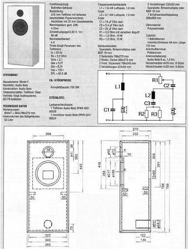

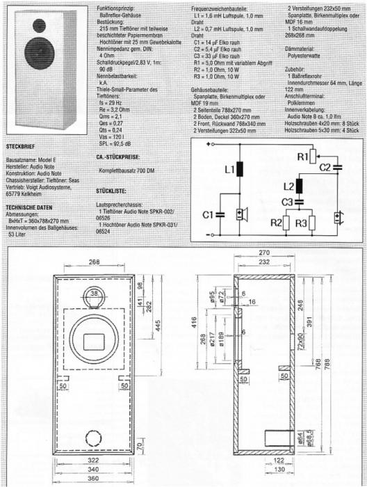

    Feanor - I found the AN E schematics - You could probably contact SEAS to get the closest driver to the one AN uses. Ditto for Tonnegan - Parts Express's owner used to work for Audio Note - so they may be able to direct you to the specific model numbers.
    But I can't imagine that SEAS has too many 8 inch hemp woofers with foam surrounds.
    There are also schematics for many of the integrated amps and preamps - like the Ongaku and M8 preamp and various others.
