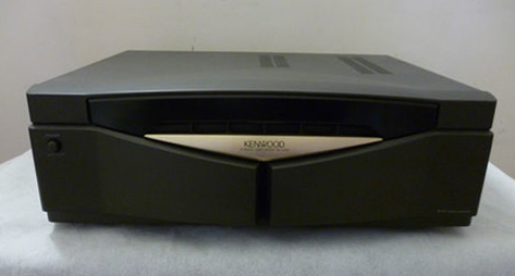

    Kenwood m a100
    hey, i'am new here, and i got this little amp, i think its's a preamp, and Would it be possible to use as a normal amp? somthing like connecting to pc, or other devices with 3.5mm. audio jack.

    Based on the manual this is a pure power amp that has no normal input connections. It uses a ribbon cable the connects to the pre-amp that would have all the inputs on it. You need to find the pre amp (C-770, 700, 550,500) under the Kenwood Series 21 system with that ribbon cable to use this amp.
