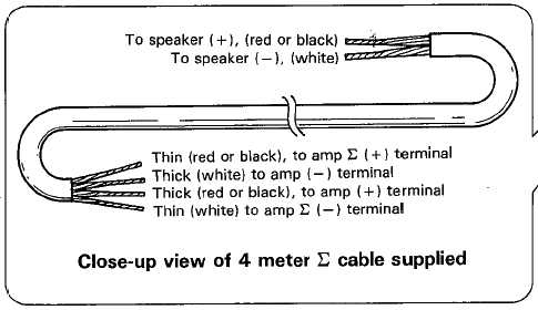

    From what little I've seen on the topic, the Sigma wire was a thin conductor for the Sigma drive and thick conductor for the actual speaker output. The original was apparently 4 meters long, which might have some technical significance if you also knew the gauge of the thick conductor. It does seem like you could replicate the original. Maybe you could try out something like 30 gauge for the Sigma and 16 for the output.

    Sigma
    I copied this picture from thevintageknob.org, which has a section on Kenwood gear. Kenwood's story on this feature doesn't mention bass response, as far as I've seen. It say the wire returns distortion products back into the amp's negative feedback loop for compensation. It claims it provides an extremely high damping factor and optimum control of speaker movement.

    Controlling the woofer and increased damping factor would lead you to believe the Sigma was similar, or the same, as a servo control.
    It is servo control but with the servo extended out to the speaker ends of the speaker cables - not just to the speaker terminals on the amp. In theory the amp could then compensate for the impedance of the speaker cables.

    Thanks everyone for your input. It looks like I will have to make my own "Sigma Cables" using a couple of regular wires of different gauge and some spade connectors.
