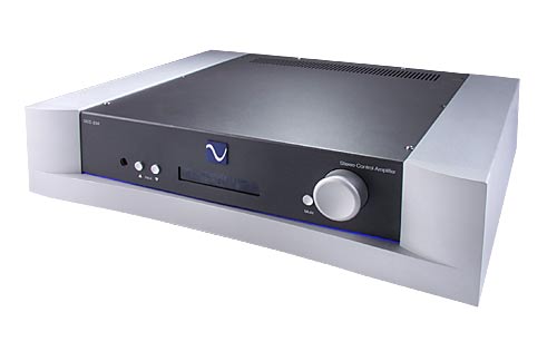

    As an example ...
    There are any number of switching amps that meet your criteria. While I prefer conventional AB amps, many folks find switchers work well and they are compact and light.
    An example of high-quality, powerful (250 wpc 8 ohms), and light (27.5 lb) integrated would be the PS Audio GCC-250.
