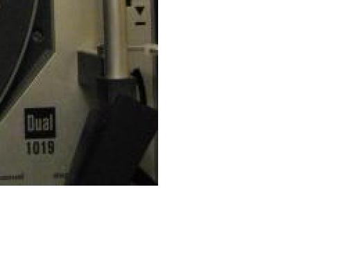

    Hey, thanks for the speedy responses. I tried adjusting screws that I believe are on the plate covering but I'm not sure. It didn't seem to help. I've taken some pictures of the machine and the screws I messed around with.

    Okay here is the screw you need to adjust, just above where it says Dual, right near the corner of the top plate.
    Attachment 6381

    I've tried adjusting that screw and nothing changes - the tonearm still goes straight to the center of the record.
