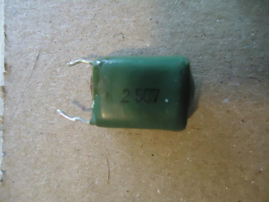

    OK, after tearing it down, (which was pretty easy, it was made to be worked on!) I found a blown cap directly in line with the left channel, it has to be the problem, but could that be the only problem? Could something else cause the cap to blow, or do they just go bad?

    Attachment 9840Attachment 9843Attachment 9842Attachment 9841Attachment 9844 Of course, I was being silly, sorry to waste your time. I'll try to make it more interesting with some groovy, far-out photos!

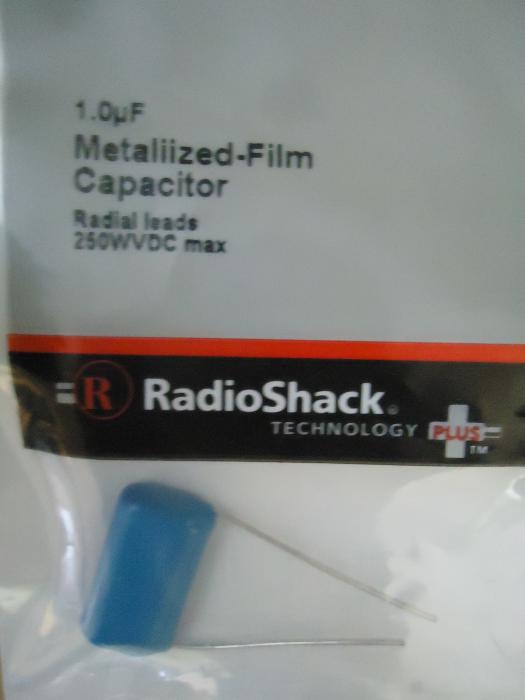

    OK, you can see the top shell of the Masterwork unit with the TT, and then you have the green blown cap, with markings only on one side and it just says "250V" --so this blue one is the closest I could find locally without doing a lot more searching, it's a 1µF 250WVDC max. You guys think the green one is a 1µF?? You can also see what part of the amplifier board it came from (the pretty blue on the corner, it's not soldered in yet), it's the very last component the signal goes through on the left channel side, and the first one I came across working backwards, luckily! I can't wait to try it! What will happen to the board if it's the wrong value? Hopefully it will just blow the cap, right?!?!?
