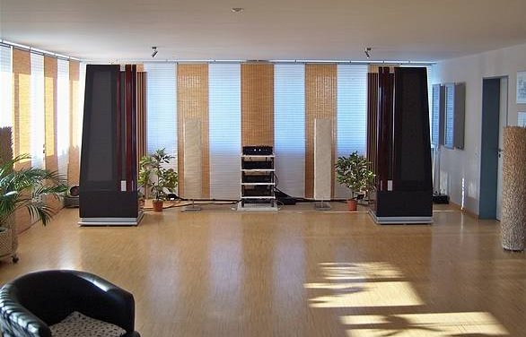

    My audio room is 880 square feet in size. (22ft by 40ft) and is considered a "medium" room for my speakers. This is a medium room for a Apogee Grand. A Apogee Fullrange should not bet in a room below 600 squre feet in my opinion. But those speakers if driven right have enough acoustical power to fill those rooms. Most systems do not.

    Bass waves are very long and require a fare amount of distance to unfold. Also the integration of the drive units tends to be better the further away you go, asuming your room does not have a lot of peaks and nulls. A big speaker like my pair requires at least 800 square feet and can unfold its acoustical power much better. With a huge dipol speaker the room is the case and they love space.
    The Apogee Grands aren't one's typical speakers, eh? That is, they were designed with large rooms in mind
    ... Florian's Grands ...
