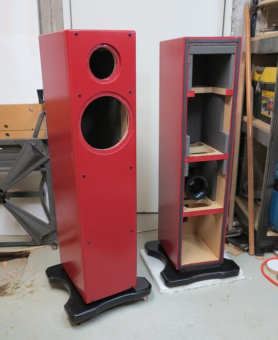

    I have pretty much complete construction of the cabinets for my ZRT 2-way projects. I still have to order Madison's ZRT 2-way kit; I'll just get the drivers and crossovers since I have everything for the cabinets, etc.
    The cabinets are 1.16 cu.ft. knock-down towers from Parts Express. I added an additional 1/4" layer to the front baffles for a total thickness of 1". Other than that, I slightly radiused the edges and fabricated the wider bases. The pics I'm including show own cabinet with the from baffle in place and the other still open. I've got front and rear views of the latter; you can see the vent tube in place. Once the crossovers are installed in the lowest section, I will stuff that section with Acousta-fill; this is necessary to prevent nasty resonances in the tall, slender cabinet.
    The cabinets are painted; ordinary water-based acrylic latex. I've never done lamination and wasn't going to try it. I applied 3 or 4 casts lightly sanding in between. I'll admit the finish ain't automotive quality but I figured I wasn't going to achieve that without spray painting. I waxed the final coat with carnauba wax. The color was chosen as a close match to the leather on my listening chair.
    Attachment 9982Attachment 9983Attachment 9984

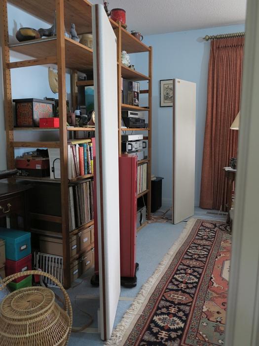

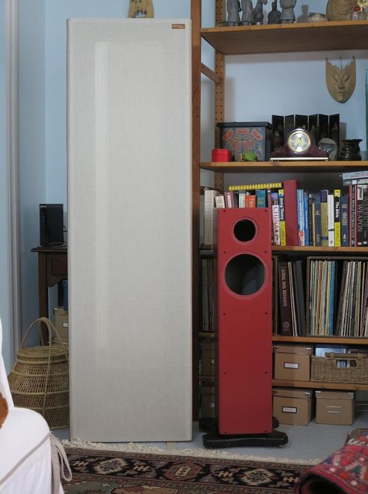

    I attaching a few more pics that contrast the size of these cabinets with my Magneplanar MG 1.6QR's. Once I've heard the completed ZRT's I'll decide whether to use them or stick with the Maggies. Right now I'm not assuming they'll be better than the Maggies. ...
    Attachment 9985Attachment 9986Attachment 9987
