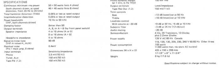

    Need help to choose good speakers for my Yamaha-610 II amplifier
    Hi, all!
    I've got an old Yamaha-610 II amplifier and 2 very cheap Toshiba speakers. I'd like to change these speakers, but I'm unable to choose something good. Can you please give me some advice?
    I was thinking about Energy Speaker Systems RC-70 Floorstanding Speakers.
    But I'm not sure it'll be good with my amplifier.
    I attached amplifier's specs, maybe it can be helpful.
    Thank you!
    Attachment 9080

    I talk about Energy speakers because it's on sale. But I'm not sure that new speakers Energy will be good with my old ampli. I'm not sure because I understand nothing in specs: watts, Ohms, Khz... So I'm asking help.
    Usually I listen rock (Pink Floyd, Doors), classic, Latina (Caceres, Buena Vista). Not loud. My price for a good pair of speakers - 1000-1200.

  • 12-27-2012, 10:03 PM
    Mr Peabody
    The Energy will work fine with your amp, the age of your amp doesn't matter. Specs aren't that important, as long as you feed your speakers a clean signal all is good. "Clean" meaning you don't over drive your amp past what it's capable of, don't let it distort.

    Mr Peabody
    I just noticed your amp is 50 watts into 8 ohms, this would power the speakers suggested to a decent level but if you like to crank it on occasion you should stick to speakers rated with a sensitivity of 89dB or better. The sound isn't for every one but you might want to give a listen to Klipsch which are very efficient, meaning they play loud with not much power input, they typically have a sensitivity of over 95dB. Using horns they have a certain sound, some love them and they have a huge following while others turn their nose, so I'd suggest a listen first.
