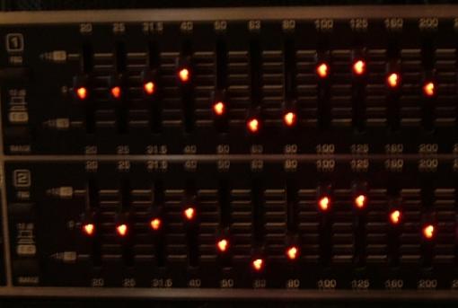

    Since I like throwing a monkey wrench into things, I'll suggest an alternative: leverage that which you already have, fix the integration issue directly and spend less money to get what might be better results. I also have a T763 and have achieved very neutral results with smaller satellite speakers and a pair of powered subs - using a third band EQ on the subs. The 763 is quite flexible on the high pass for the subs where I set mine to a higher setting than most - 120 hz - so that the EQ can address the room modes. My den has two significant peaks/valleys that I am able to correct without running the EQ full range and compromising the signal. I find that biamping does great because any potential bass clipping has zero affect on the majority of the sound. I would recommend choosing one of the two way monitor flavors of your excellent choices along with a pair of equalized subs.

    E-Stat: you mentioned a third band EQ on the subs as a way of taming room interaction. Sounds interesting. What type of equipment would I use to accomplish this, and how would I set it up? Oh, and most importantly, what would it cost?

    Quote Originally Posted by RoyY51
    You will need a couple of useful tools: Sound pressure meter, CD test disc, and equalizer. I use a Radio Shack digital SPL which can be purchased for about $50. Stereophile has test CDs for around $12. I use a Behringer FBQ3102 EQ which can be purchased for under $150.
    The process is to measure your system characteristics so that you may optimize speaker placement, subwoofer level, receiver high pass crossover frequency and EQ settings. The objective of course is to get the most linear response in the primary listening area. Remember that while this works, it is not as advantageous as room correction which is a broader solution. By this I mean using bass traps, acoustic panels, etc.
    Although this is an oversimplified explanation, virtually all rooms suffer from modes. They are frequencies that are either boosted or cut depending upon the dimensions of the room. Square rooms provide the greatest challenges since they tend to reinforce the effects and are more challenging to fix. In my den, there was a broad peak from 50 hz to 80 hz with an attendant null from 100 hz to 160 hz. Sometimes that can be alleviated through placement. Unfortunately, I had very little lattitude in this room. The EQ's job was to mirror those errors in order to flatten the response. Since the suckout was pretty profound, I was not entirely able to correct it, but I was able to completely remove the obnoxious peak.

    You've obviously thought this through. Very impressive tutorial! I've already got the RatShack SPL meter so I just have to free up enough money for the disk and equalizer.
    Thanks for the great advice!
