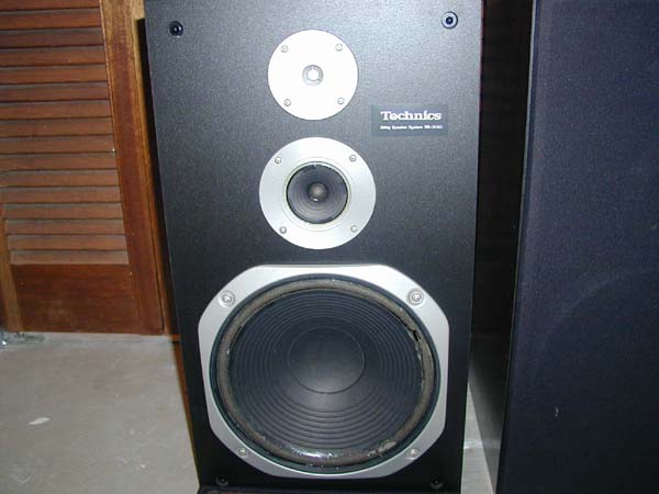

    heres what the speakers look like pete, they look kinda messy here, but ive got the woofers all cleaned up and the speaker is in great shape now. and it sounds awsome from the short tests i have. i turned the bass all the way down and the treble up a bit. so i wouldnt put alot of strain on the woofers.
