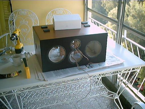

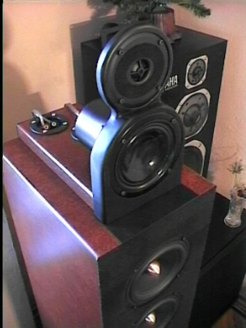

    I completely agree with this opinion.
    Attached is the photo of my HT system (photo taken more than 4 years ago).
    All the speakers in this photo were built by me. Actually there are 2 sets of speakers in the photo. A small pair of speakers and a small sub at the bottom is for casual TV watching.
    Research, design and construction (including woodwork) of my main left & right speakers took 2 years, working on it some evenings and weekends. The center project was much faster as I had all the parameters by then.
    How does it sound? I'm completely satisfied.
    The large sub's (left of the photo, under the electronic equipment) woodwork was done professionally (50 mm mdf baffle, 30 mm mdf all around). It has 15" woofer in closed enclosure and 500 wrms amplification.
    A pair of Yamaha NS1000M as surrounds, and a pair of Wharfedale surrounds as back surrounds complete the system.
    My most used audio/video source now is a Popcorn Hour C-200 media player.

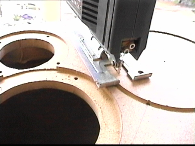

    Some more photos...

    Nice!
    One question...
    Do you think building the midrange tweeter outside the box helps the sound? It certainly looks nice,

    Outstanding job but I could never come close to your woodworking skills. I do think most people on this forum could build basic enclosures if properly motivated.
    A couple of years ago I took a one day course at a local woodworking store in making kitchen cabinets which involves the same principle as making a speaker enclosure - i.e. joining four sides of a box together at right angles and adding a top and bottom. We learned to use a Kreg pocket hole jig to join all the sides. Youtube has several videos showing the tiny inexpensive jig in action. All one really needs is a pocket hole jig, a drill, wood screws, glue and a jig saw. Lowes or Home Depot will make all the cuts free of charge if you buy their plywood or MDF.
    If you have curves to cut or more complicated designs most large cabinet shops have CNC machines and they will make all the precision cuts for a small fee. I did this with my Frugal Horn Mk3 builds and they came out great. I'll try and post a picture in this thread.

    Without the parallel surface to travel and edge refraction I believe it definitely helps achieving an open sound.

    I'm sure you can do much better than me. I consider myself a novice woodworker. I do take care and not hurry. The enclosures were good looking even in their raw mdf form, before applying pvc.

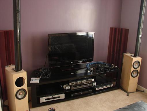

    The reason I asked was that my DIY's have a ribbon on top that is open air and it creates a very open sound. Your's is similar in concept.
    I've attached a picture of mine. They are unfinished and I know that I made some mistakes, but this is a first for me. They sound way better than they look. I'm almost embarrassed to let you see mine after seeing your's. Oh well, it's all good!
