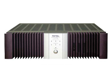

    I have a bit of first-hand experience with the problem you may encounter. When I upgraded from fairly easy-to-drive speakers to Martin Logans I needed an immediate infusion of current. I grabbed the Rotel RMB-1066
    Its a six-channel amp that I run in bridged mono across my front three speakers. Makes for a very coherent front soundstage that just sings. I have heard this unit with B&Ws and the results are pretty nice. Originally meant as a short-term stopgap, I suspect I will be dealing with source and room issues long before I will feel the need to upgrade to one of the big Ms ( McIntosh, Musical Fidelity, Monarchy Audio, etc.)

    "Bridging" indicates that I am using the current from two amp sections on a single audio signal path. For example, amps #5 and6 power a single signal to my left speaker. This is really only necessary on low sensitivity or "hard to drive" speakers ( the reverse situation is when you hear about characters using low wattage SET amps to drive highly sensitive speaks). The Logans aren't a horribly tough drive like some of the bigger Maggies or Flo's Appogees, but they do like some current to sing their best--at least more than a receiver was going to provide.
    I have never owned B&Ws but have heard many and have also heard a majority of those that own them concur that they need a bit of juice to really come alive. I made the suggestion because if you're already grabbing 802s ( and pretty soon you'll want a matching center and, then, why not surrounds?!!) then you're already spending a fair amount of cheese all at once. The Rotel is a nice budget unit that performs exceedingly well for not a lot of dollars.
