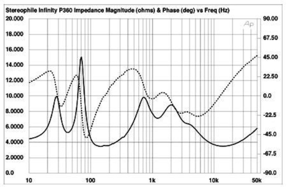

    As I suspected, your speakers may seem like a benign load with their 8 ohm rating, but are actually presenting a very difficult load to your receiver, causing it to go into protection mode. I searched for and found a review and bench test of the Infinity 360 in Stereophile Magazine that reveals why.
    Although the Infinity 360 is rated at 8 ohms nominal, its impedance drops well below 4 ohms in critical areas of the audio band, and also presents a quite severe phase angle to the driving amplifier. What the latter means, is that impedance and phase are out of sync at several points in the audio frequency band, making it a taxing load for the driving amplifier.
    You either need an amp that can drive low impedances with no problems, or get different speakers. The Infinitys seem exceptional for the price, and you would need to spend a lot more to get speakers that sound better. An external amp driven from the receiver preouts may be a better solution.
    Here is the quote from the Stereophile bench test:
    "However, with an impedance magnitude that drops below 4 ohms in the lower midrange and high treble and an electrical phase angle that is extreme in the upper bass (fig.1), the speaker needs to be partnered with an amplifier or receiver that can drive low impedances with aplomb. (The combination of 5.2 ohms and –45º phase angle at 93Hz will tax amplifiers rated at 8 ohms.)"
    Solid line is impedance, dotted line is phase.
    Attachment 9196
