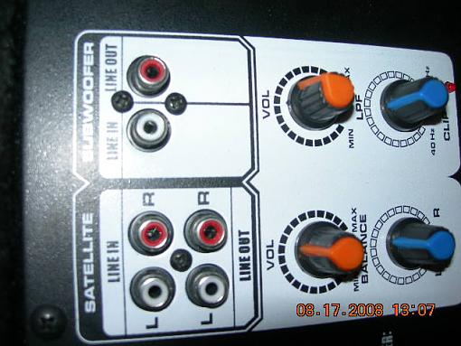

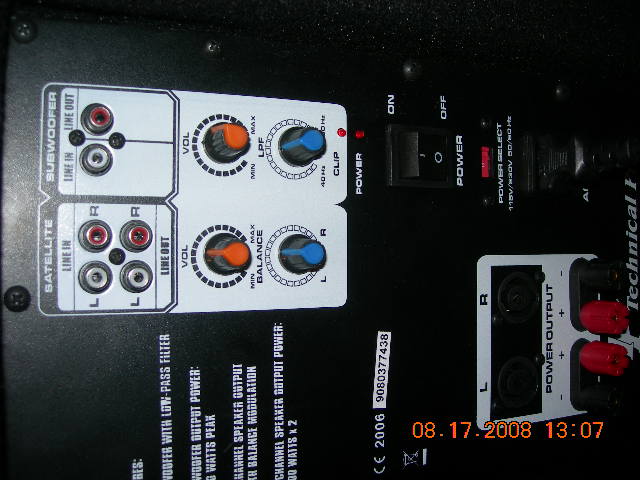

    OP here and i got some pics, i currently have only lows coming out when the RCA is hooked up to the subwoofer line in port, but when i touch the other RCA (from the 1/8 to 2 RCA's) to any of the other ports on the metal out side of the port i can get some vocals for some reason, still need some advice guys!

    Its simple, basically.
    Go to the "shack" (radioshack) and get an adapter, a stereo mini plug
    on one side and two RCA plugs on the other, and a mono mini plug with an rca on the other end.
    If it says left, right, and sub on your sound card, get three adapters, mini mono plugs on one end, rca's on the other.
    Plug the left and right into the sat line in (they're labeled) and the sub into the sub in, hook your speakers into the terminals on the back.
