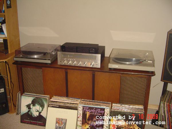

    Sorry LDB, didn't know you were an electrician yourself. Learn something everyday. Gonna jack your thread for a sec. Came to a standstill with my racking. Might be a few more days but I had the urge to re-arrange, since I would have to make room anyhow. Here's the result...thanks for the inspiration...
    Attached Thumbnails Attached Thumbnails Time to think about power conditiioning.-dsc02424.jpg
    That looks better. That's the way I have my components laid put, side by side. I never stack my gear. If I had them in a rack I would have a shelf with proper separation for each piece.
    Cheers
