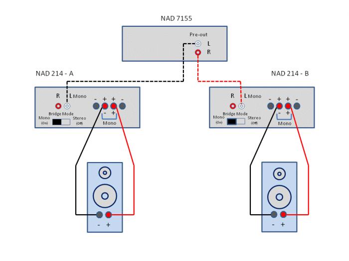

    Thanks so much for responding Feanor! I'm assuming that the Left RCA output coming from the Pre-out on the 7155 would go to the Left input on 214-A and the Right RCA output would go to the Left input on 214-B per the attached crude diagram. Attachment 9995
    Yes, that's right. Per the instruction on the rear of the amps themselves, the both the Left and Right outputs on the amps go the Left (Mono) input on the respective amps.
