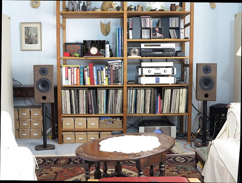

    Some pics ... note the speakers stand are far from ideal: they are too tall and too spindly.
    Attachment 9949Attachment 9950Attachment 9951

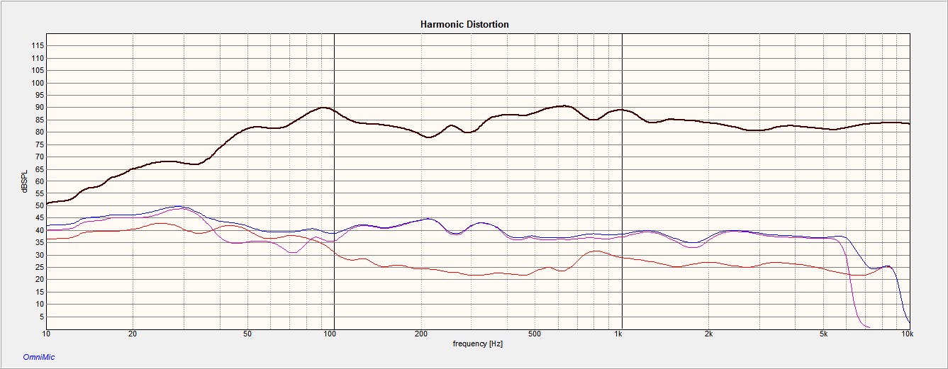

    I finally figured out that I could measure harmonic distortion with my Dayton OmniMic microphone and software, so I did it today.
    The measurements were taken in my fairly well damped, (but definitely not anechoic), living room is pictured my original post, except that the single speaker measure was moved to the coffee table and the mic place 1 meter from the speaker.
    The graph below, (click to enlarge), shows frequency response, (top, black) and total harmonic, (middle, blue line). I think it looks reasonably good. Frequency response looks reasonably flat from 50 Hz on up. Harmonic distortion looks pretty good with a main-band high around 200 Hz of a relative -33 dB, (2.2%), and about -51 dB, (0.28%), at 1000 Hz.
    I had some concern that my select crossover point of 1500 Hz was introducing distortion from around there to about 2000 Hz on account of the tweeter's reputed performance, but there is no indication of that.
    Attachment 9960
