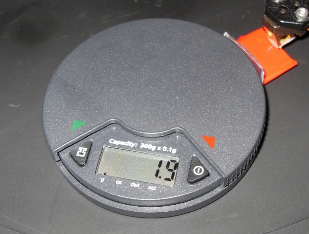

    Unlike DarqueKnight from the Polk site, I ended up paying $34.15 for the Jennings Mini 300 and a 100g calibration weight. I'm not going to post my procedures since DarqueKnight has already done a great job. The only difference is I used a corner of an empty CD case instead of gluing 2 pieces of thin plastic.
    Digital Stylus Force Gauge: Jennings Mini 300-w-flash.jpg
    BTW, when I had set the VTF with the Shure SFG, I had tried to set between1.75 to 1.8 grams.

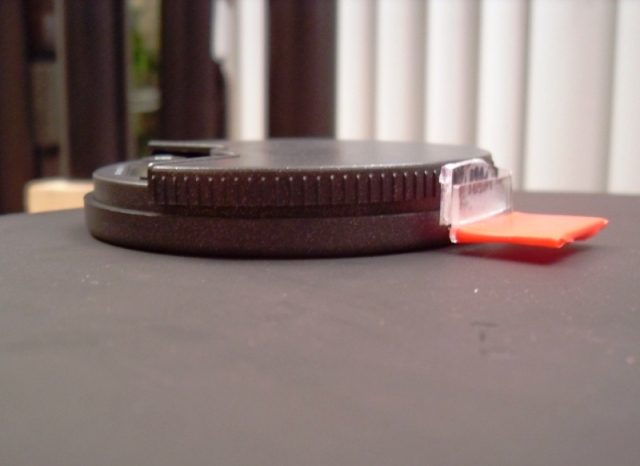

    Digital Stylus Force Gauge: Jennings Mini 300-side-view.jpg
    Accuracy of the unit: Very Good.

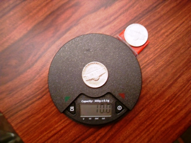

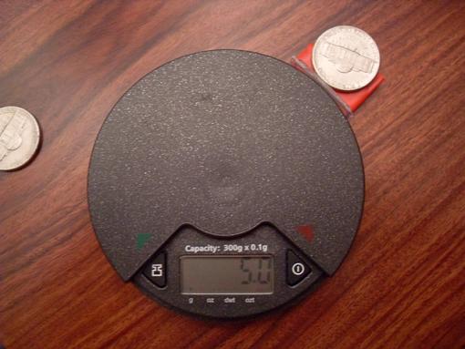

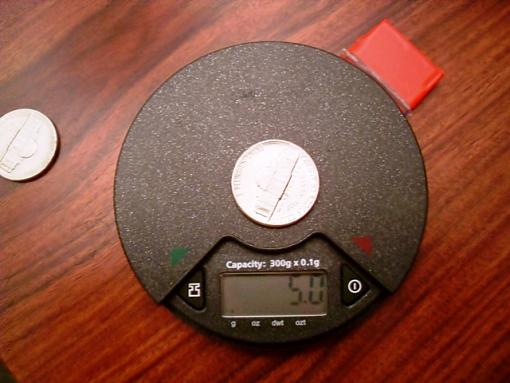

    Ok, that sounded a bit confusing so I took some pics of another experiment with US Nickles. If you didn't know, a Nickle weights in at 5.0 grams. If you don't trust me, ask our boys in the RR section.
    Digital Stylus Force Gauge: Jennings Mini 300-5g-center.jpg
    Digital Stylus Force Gauge: Jennings Mini 300-5g-stylus-gauge.jpg
    Digital Stylus Force Gauge: Jennings Mini 300-10g.jpg
