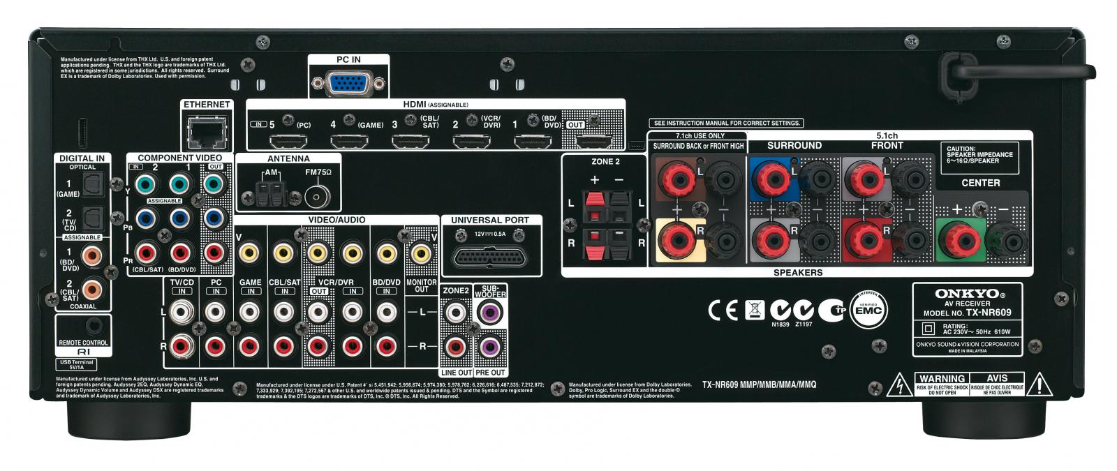

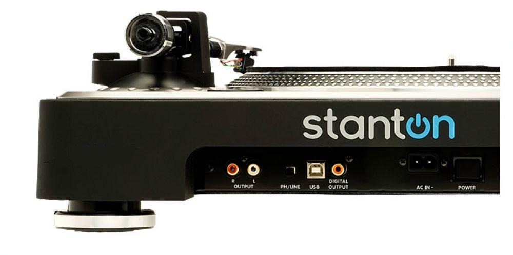

    Hey guys, i got borrowed from my brother this phono preamp TCC TC-750. I dont really know if itīs good, bad, or regular. the main purpose is to try it with my turntable, see how it goes and if it does, then maybe consider investing on a better one to imporve the sound quality.
    I have the doubt of how to install it, so im posting a couple of images from the rear part of my AVR and the input on my turntable, see if you guys can give me any advice o instructions on how to set it up!!
    this is my NR609, my turntable t.92, and the TC-750 i just got.
    i really appreciate your help guys. hopefully ill get some instructions!! thanks!:)
    Attachment 9406Attachment 9407Attachment 9408
  • 07-11-2013, 07:10 AM
    Hyfi
    Left and Right Output from Stanton to input on Pre
    Then l & R Output from Pre to PC or Game input on AVR

    Hey guys!! Well I finally plugged everything properly, but for my surprise, I'm not getting anything from the phono preamp, I've cheek everything and seems to be well set up. I tried with the phono and direct to the AVR and I'm getting the same power.
    Actually, with the phono I'm just getting sound from one of the two speakers... I don't know who this might've happen... Any of you guys have any idea?? Suggestions ??
    Thanks again guys, I appreciate it!!
  • 07-14-2013, 03:20 PM
    limonv
    The thing about the speaker was that it wasn't connected properly, apparently my little brother managed to disconnect it. But still, I am not getting any more power with the phono preamp than withou it.
